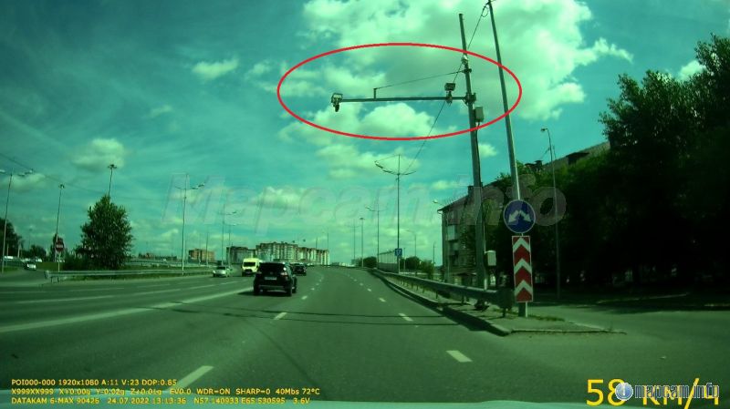

24 July 2022, 09:43:50
Новая камера +1
24 July 2022, 09:43:54
Новая камера +1
24 July 2022, 09:44:52
24 July 2022, 09:49:26
Gold76, changed object type from  Traffic control complex Traffic control complex to  Static speed camera Static speed camera.
24 July 2022, 09:56:14
Актуализация +1
